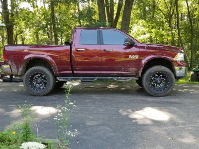

Go 6in and be happy with it lol
This is a 6in zone lift with bils at 2.1

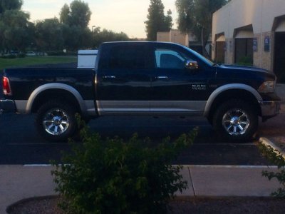

I have given this advice many times. I almost went this route myself so I saved his truck pics. Someday I might lower mine down to this setting and run a smaller tire. That's what's great about the BDS or ZONE lifts...adjustability.
Here's the truck with BDS/ZONE 6", no preload spacer (his struts are bone stock and required no disassembly) with 3" rear coils. He has 20x9 +0mm wheels and 35x12.50R20. Has a nice stance with the OEM flares IMO.
