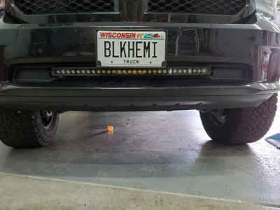

20200620_180636.jpg I have a 30" curved single row light bar on mine. It's still bright as heck, regardless of the 30" vs your desired 50"

I used the supplied brackets into a flat piece of bar stock. just cut to length and drill holes for the bolts.
