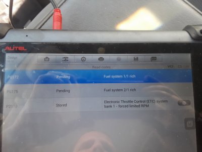

Here are some observations and a picture of scanner codes after multiple resets:
1. Changing Throttle body did not fix issue
2. You can unplug the IAT sensor while truck is running and there is no change good or bad (does throw code when unplugged)
3. Moving wires near the bulk head next to ECU sometimes will change idle but the connections are all clean and no broken wires visible after checking for quite some time.
4. Seems to idle worse when connecting the air intake back onto throttle body.
5. Symptoms like a bad IAC and always looking for idle.
Thoughts or suggestions?

The flashing lightning bolt is a warning that there is an issue with your electronic throttle control system (the P2110 code you showed us). It sounds to me that your issue may be your TPS or IAC, Trupiano has basic information on the sensor. I don't know if they changed over to a drive-by-wire system with the 4.7L in 2008 or stayed with the cable. Fix that first and your P0172 & P0175 should clear.
https://www.ramforum.com/threads/en...info-troubleshooting-guide.18583/#post-343200
The TPS and the IAC are both built into throttle body. I changed throttle body and it did not fix the issue.
