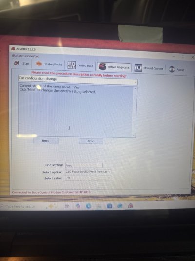

Looking for some help with alfaobd.I am trying to change config on a 19 bighorn our used car department purchased, it has a Laramie swap ie lights, radio , mirrors,seats..
I have the software and license.
Anyone done this change

it sounds like you are hoping there is a quick and easy way to swap from Bighorn to Laramie.
There is not.
You'll need a list of each and every thing that needs changed. Some of those things will likely require multiple setting changes per item and others only 1 setting change.
Make a backup of your BCM config first, otherwise there is a good change you'll be flatbedding this thing to the dealer for a BCM flash when you screw up. Then go through and make 1 change at a time, keeping track of everything you did.
There is not.
Lots of truth to this wisdom.
Practice on making backups and verify they are stored.
then practice on very simple changes to get some skills and practice.
The fogs on with High Beams is what I started with - easy to do and easy to check.
You are going to be making some very complicated changes, so best to start with some very simple changes. Ohh write all changes starting and ending values, in a notebook, and backup every time you start and end and change the names of the files so that you can restore back when needed. This is going to be a time-consuming set of tasks
Good Luck - YouTube can be your friend - reading lots of posts is also worth your effort.
