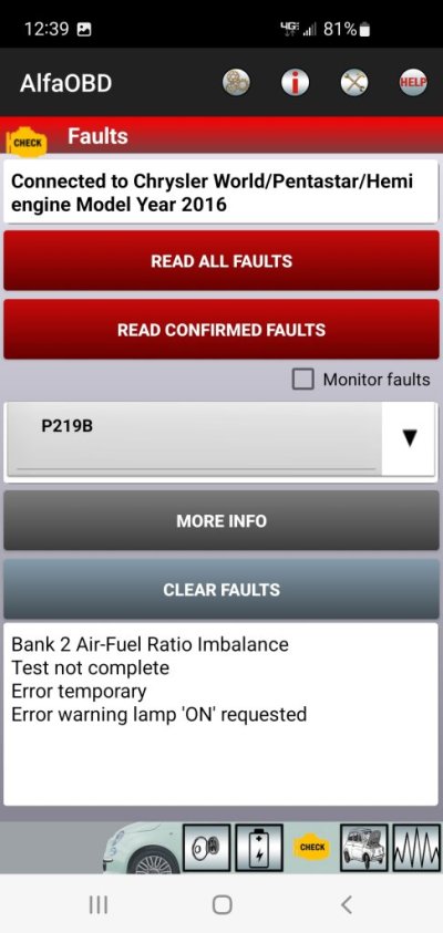

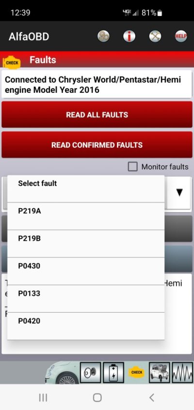

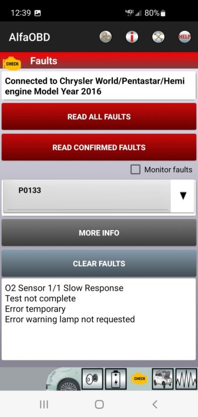

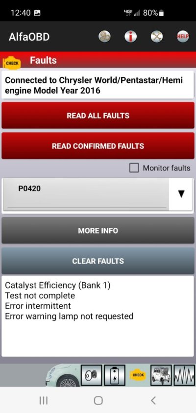

I had long tube headers installed a few weeks ago and since I've had these codes
Would a tune be able to get rid of these codes?

Because one of my codes is the upstream sensor, i cant see those helping
I wish one of the tuners would pipe in and tell me they could fix the light for me

Have you smoke tested the exhaust from the collectors to the heads,as usually it's a leak ahead of the collectors that trips the front 02's
@AMP4X4 is this something you can fix for me?
Yes a custom tune will get rid of your codes. Not sure who to use anymore its been 10 years since I had long tube headers. I have used hemi fever and jay greene in the past. The only thing with lt is that they wont pass emission testing. Hopefully your lucky enough not to have to worry about that

Basically yup.Are you using OEM 02's,or after market replacements.Alot of guys don't realize the 02's should be replaced as part of a good maintence schedule,as they do degrade over time
I had a shop put the headers on, and i had them use remflex gaskets, so there shouldn't be any issues there
(Wont hurt to double check though)
The O2 sensors are the stockers, so they have just over 100K on them
Because of that P0133, im thinking of swapping the two front sensors
That should tell me if its in the exhaust or the sensors
Ive just not been able to get the passenger side popped loose
