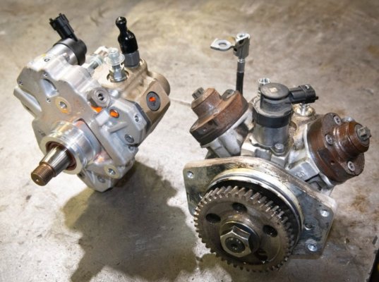

Main concern with a 2019 is if the recall was done for the CP4 pump which it probably wasn't. But you can check, it should look like the pump on the left CP3. The one on the right is the CP4.2 that should be replaced.
The pump is located on the drivers side of the engine block.
