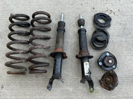

Unfortunately the eibachs are out of my price range, this project has given me enough money burning rabbit trails I’m not in the mood to drop another $300 lol.
Got to looking around and I realized the cheap struts have a different lower spring perch that I’m not sure would work with the bils. So i ended up cutting apart my old stock struts, I’ll be able to use the coils from them and then I’ll buy the upper mount and the lower perch (old ones are seized onto the strut). Coils aren’t in too bad shape actually, a little cleanup and some paint and they’ll work fine.

You will need to find a way to get those lower spring perches loose. I have not seen them sold separate anywhere. Some kroil or something to break down the rust and a small sledge hammer.

Thanks for the heads up, after a quick soak in break free that actually came off first try!

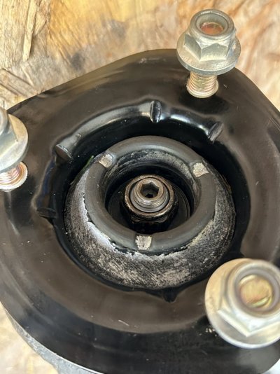

Is it normal for the top mount and spring to sit this cockeyed or did I mess something up? And is my top nut on far enough?

Couldn’t remember but it tells you in the paperwork that came with the bilsteins. The tops can sit crooked because it is just a rubber bushing. It’ll sit right once mounted in the truck.
