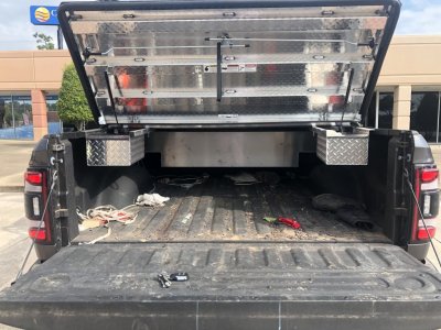

Reconsider diamondback. I ran two ATVs on top. Plus I opted for the extra boxes for my gear.

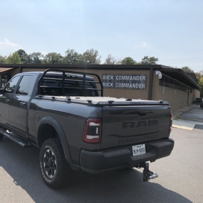

I see your point. I would not be comfortable carrying 2,000 lbs on top my bed while off roading. Being that you have a Power Wagon might I suggest posting on the Power Wagon thread. You will get more hits from those of us in a similar situation. I now would suggest a roof rack like @Maligator has. That would hold your smaller gear you don’t use every day
Trailmaker
Locked and Loaded
Jul 28, 2019
1,814
1,687
Conroe Texas
2021 PW
@Maligator also has a rack system that could be more your style @Travelin Ram

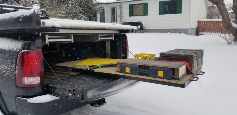

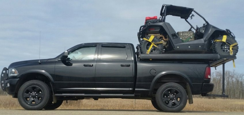

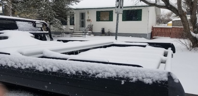

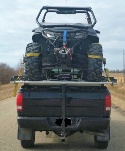

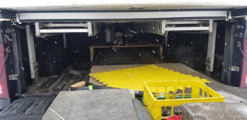

There is these risers to tuck the rear in or the black Dodge with deck and arctic cat trail is my ride. Under deck for gear. I've driven on some sketchy roads trails and with the tire tie downs cat stays still. The deck is secured on deck rails and leg support on 4 corners in box. Roll out under deck. Deck extension flips up when not in use. Marathon truck boss deck. Sorry about the snow.
