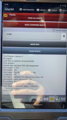

I just changed new fuel wheels and tires .
Everything goes well . Except few minutes later , lost two front wheels from TPMS.

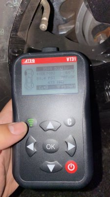

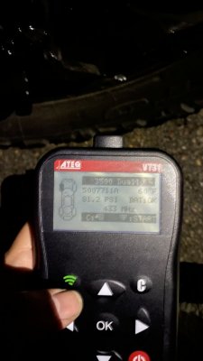

Checked with TPMS scanner , it is fine .

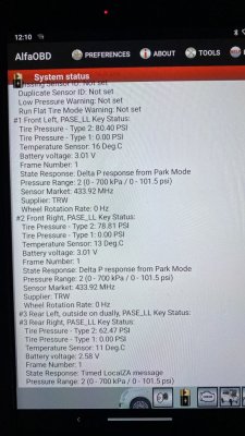

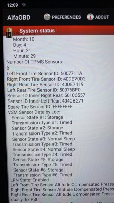

Use AlfaOBD found two codes. C1501,C1502z
Clear codes . Two front wheels got back .
Drive for about half hour .
Same issue came back .
Same codes. Same clear codes. Same fixed . Then same came back again and again and again.
Any idea?

It’s possible they damaged your factory sensors I would replace them. It’s pretty easy to get them snagged on a tire. When you clear the code the truck needs time above 20mph (rule of thumb 20 minutes 20 mph) that’s about the time they kick out again according to your op. Unfortunately they are not serviceable. I would say rotate the tires but it appears you have a dually
