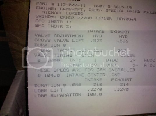

You need a cam. One that is designed for more torque then topend. I used to have a Comp Cam that was a torque monster. I could definitely feel the torque increase and was way fun around town. Not to mention it would lope hard af :). You could hit up Jay Greene for a custom grind or go out and get the cam I had directly from Comp Cam.
This is a video of my truck with that cam. Doesn't do it any justice but you can definitely here the lope when the cutouts are open in this video.
https://youtu.be/7yTlfJC1hZk
This is the cam card on that torquey cam, it was a 210x cam by KRC
