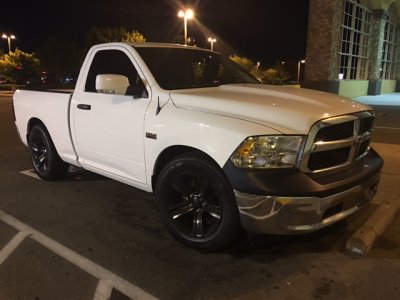

I lowered mine for the same reason. I used to drive Hummer's for years but recently became disabled and was experiencing much leg and back pain from getting in and out. When I purchased my 17 Ram for my daily driver it was a little high for me so I had it lowered 2" in the front and 5" in the rear. Easy to get in and out now, no more pain, drives great and look better lowered too.
