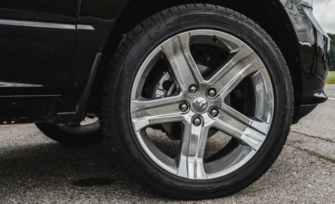

These are the wheels I'm talking about.

Stock wheels/tires fit just fine with a 2/4 drop. When you change wheels you just need to pay attention to the total height of the tires, the 305/45R22 is a popular size and the closest to your factory tire size but can have minor rubbing issues on some trucks, the 285/45R22 fits with zero issues but they're 1" shorter. If you get wheels with a lot of offset you'll start rubbing the inner fender liners, so you just need to get ones with similar backspacing to the factory wheels. The newer R/T wheels bolt up the same and have the same backspacing as your stock 20s so they'll work the same.

What is a safe offset?
