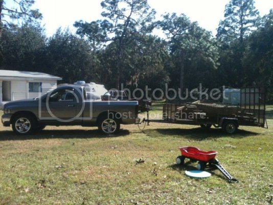

I know it's like apples to oranges with a Gen3's leaf springs compared to a Gen4's coil springs, but look at mine...this is with the rear lowered with shackles, still have the OL leaf installed.

This is precisely why I want to use Tufftruck +25% springs, cut down, to achieve my rear level. I'm going to get more familiar with the truck and its sag while towing before deciding, then it would be only a matter of swapping out the Airlift 1000 bags from Ram-Grand Cherokee along with the new springs.
