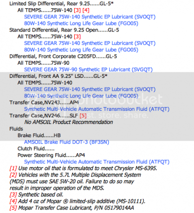

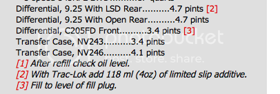

when u guys use the amsoil or the royal purpl ein he diffs, do you still need the mopar limited slip additive
According to the Amsoil product chart it says you should add the additive if you have LSD in the rear and are using their product.
I then also found this on their site which confirms what Heath said
"NOTE: AMSOIL Synthetic Gear Lubes do not require the use of this additive. However, not all differentials respond the same and if chatter is noticed, the addition of AMSOIL Slip Lock will eliminate it. For chattering differentials not running AMSOIL Gear Lube, this product is an excellent solution to the problem."
