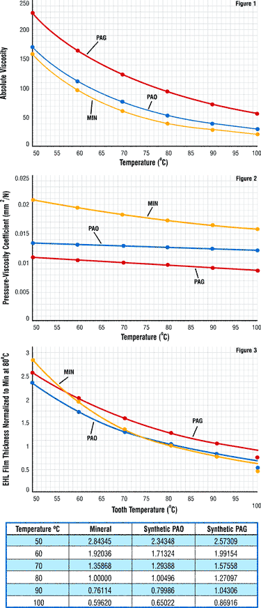

So look at this chart, it shows an oils film strength as the temps rise. group 5 oil has around 30% greater film thickness at operating temps. That means you have better protection for metal to metal wear. In every possible test, group 5 is more beneficial then the others, plus they last longer because they don't break down as easy under temps.
PAG- group 5
PAO- group 4
Min- groups 2 and 3.
