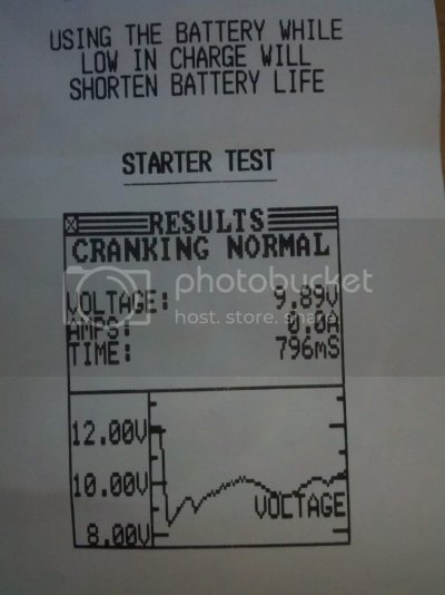

Hey guys, having a problem with my truck. The battery keeps draining, i have to jump start the truck everyday and it will last me the whole day, but the next day I have to do it all over again. Took it to advance to do the battery test/alternator test and "supposedly" everything checked out. Here is the pic.IMG_20130308_152855_zps4dcf615b.jpg IMG_20130308_152848_zps60d3f2cc.jpg

Thanks for the quick reply. Are they right at advance, according to the picks? What would I do if I find the culprit?

I'm never one to trust their "on the vehicle" testing mahines. I always pull mine off, rather it be an alternator or battery and have it bench tested. But, with that being said...do you have an alarm or anything installed?

Thanks for the solid advice guys, however I think I the battery was the problem, I was getting the battery tested @ advanced, the battery is an autocraft gold, and they kept telling me that the battery was good and that it was charging well, so out of embarrassment, cause they had charged 4 times before, I went to autozone and within 10 min i get a call back that I have a bad cell. I go back to advance a little pissed, get a new battery which I haven't hooked up yet, I'm still going to do the drain test to see what i get. Thanks everyone, I'll update once I know something.
