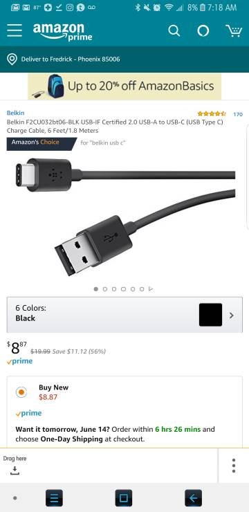

Better USB c didn't solve the issue...

I dont know about your pioneer but I ordered certain c-usb cords reccomend on the pioneer site and it worked on my pioneer 7200. I'll try and find the list
WadXpress
Nov 29, 2014
1,162
399
HEMI
I dont know if these will solve your issues. I'll be back in vegas this fall so ill have this issue next summer if it's not a cord issue
WadXpress
Nov 29, 2014
1,162
399
HEMI
Neither of those are listed on thAt page. Order the belkin that's listed on there. I got it off amazon I think
