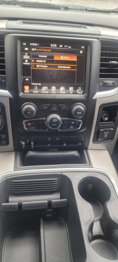

I just bought a 2017 1500 Big Horn last week. I have been non stop reading and I understand the upgrade for the most part. I want to be sure I have this right.
1. Buy used or new 8.4 Uconnect radio if I want to keep the OEM look. ( What I don't know is if it need to be out of anther truck or will any 8.4 work. )
2. I am putting this in a 2017 so I should try and look for a 2018 or 2019 to be safe and to stay away from Harman Kardon? ( Not sure why that was )
3. This should be plug and play for me as I have the same size screen and wires now. ( 24 hours for the new deck to boot up fully and all functions will return )
4. Replace the USB hub and wire in the arm rest with a new one from the 2018 or 2019 otherwise Apple care play and Android Auto wont work .
( I don't know where in Canada to get the hub and cord I found the Hub on Amazon but not the conversion cord. )
Thanks for extra advise anyone has. We have two 2017 Ram's so I may need to do this twice.
5. Has anyone put in an aftermarket that was around the 7 to 8 hundred mark and love it. I do like the OEM look as well.
