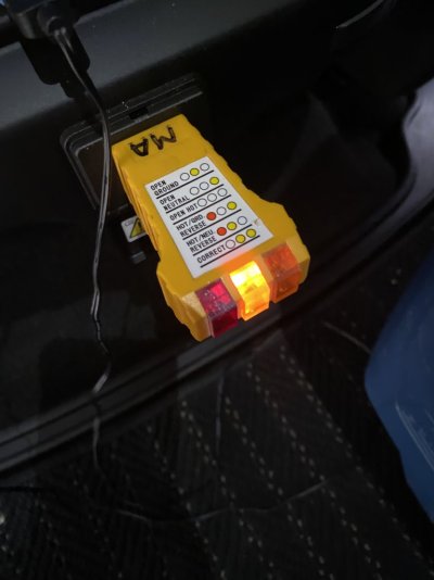

would one of those $5 outlet testers work on the truck outlet? what happens to ground on a vehicle 120V AC outlet? I may have to try this for curiosity sake.
It should report a faulty ground as it's not connected to the neutral as in a typical home distribution system
