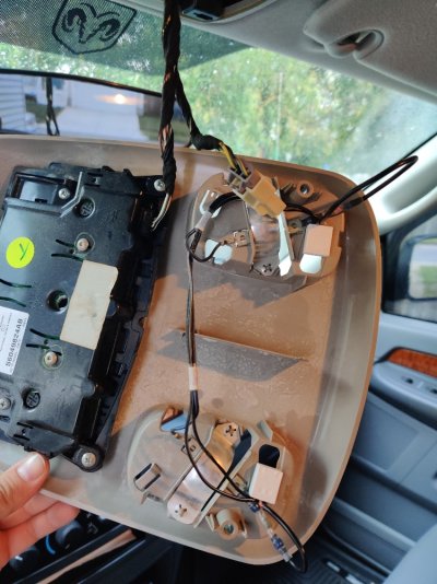

Took the assembly off, looks like someone has been here before me snipping wires. The switches aren't even in here anymore. I'm going to attempt to extend the wires a bit and connect them to the switches I linked.c9cb428990528e1bfe62572a47a3a08f.jpg77ee060ecb1866e221bc8c4a1ad7e22d.jpg

Half-ass wired it all together. Both the bulbs were burned out so I used the dome light bulb to check if I was successful. It works!
I just shoved the bare wire in the switch pin holes... Is that how it's supposed to be done?56bb8076cfd328a8dbbcb9072cf7a357.jpg
