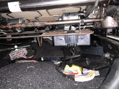

I've gone through older posts from this site and others and most seem to be a dead end. Just curious if anyone has found any way to add memory seats into a non-laramie trim truck. I have a 2500 Big Horn with heated seats and am about to upgrade to Laramie front seats that also have the memory option. Is it impossible to get the memory settings working? Thanks in advance.

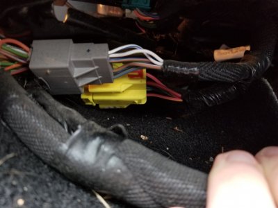

Take a picture of the wiring harness, there is a guy with an SLT it just worked out of the box. There is a way to get them running if you dont have the proper harness with the drivers door module. You need to be ready to run a few wires or buy a harness built by an in house vendor here.
Take a shot of the 2 harnesses under the driver seat, you might have a fully populated harness that might get lucky.

Thanks for the reply, I'll take a picture in daylight. I have no problem running wires or grabbing/wiring modules as long as it works. Do you happen to have the post of the person with the SLT? Didn't see it in my search.

Read the original post to see if your BigHorn has the same factory options and wires in the connectors as the pictures.

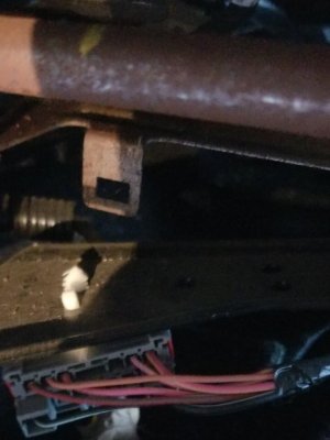

Would you guys be able to tell me if my wiring is correct to do this? Need this lol!!
