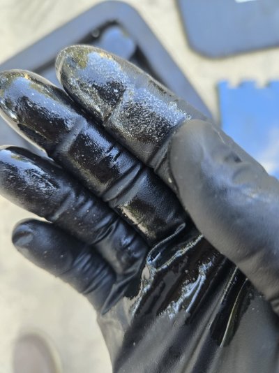

Hey I have a 2104 ram 5.7 just put a remanufactured engine in and did the first oil change at 500 miles and there is a significant amount of silver in it. Should I be worried?1000005940.jpg

First oil change could be leftover remnants from doing a poor job keeping things clean during rebuild. I would probly refill and run a few hundred miles and if it's still bad then go with @Slinge and have an analysis done.

I dont think I'd panic. The filter should catch all the big stuff. Whatever damage is gonna be done is probably already done. I'd probably do a short interval change and if it still has good oil pressure and normal crankcase pressure I'd just run it.

Thanks I'm going to run another 500 and di another oil change and just hope for the best. But it does seem to have some valve clatter with slight revving.

The oil pressure goes down to 27psi at low idle. Is that normal? The engine before was around 38psi at idle.

go ahead and do a warranty claim on it and see what they want to do
That's what I'd do. Being down on oil pressure with metal in the pan is concerning. Could be that they just didn't clean it well or it could be ready to spin a main bearing.
Try to get your money back and see about a getting an engine out of a wrecked truck or something. I've never heard of a good experience with any parts store reman engine or transmission.

Yeah but I git the reman for 3200 with 3year 100k warranty a used one in my area is around the same price with maybe a 90day warranty if lucky

By the look of that warrenty,i'd say you're better off with a wreckers 90 day warrenty. That warrenty is hardly worth the price of the paper it's wrote on in my opinion.

Glittery metal in the oil pan would be bearing failure, (mains, rods, Cam) that is why lower oil pressure, probably a main, get a used engine your odds are better that remanufacture.
$3,200 if you bought all the OEM parts for a rebuild it would of cost you more.
