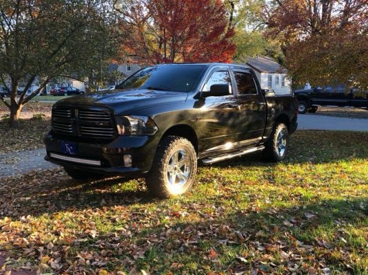

Ok, I have a 2016 with only a 2" Rough Country level. I'm buying Michelin Defender 35x12.5x20's to mount on my stock chrome clad 20x8's. I also ordered a Rough Country .25" spacer just incase there's any rubbing.
My question is does anyone here have a similar setup that I could see pictures of? Also any advice would be cool, too. I went with the Michelins because I'm not trying to totally destroy my MPG. I know they aren't the most aggressive-looking 35's. I attached a picture of my truck with just the 2" RC level with stock wheels & tires. Thanks all!

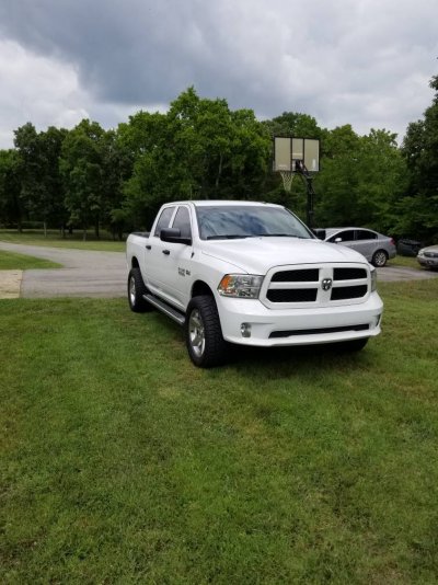

Are you sure they're not 20x9? On my 2017,they are. I'm running 305/55/20,with no issues at all.
