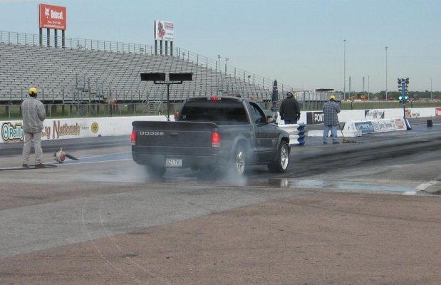

Is this the same QwikKota from the Dakota R/T boards back in the day?

QwikKota
QwikKota
Apr 2, 2015
1,528
1,112
5.7L
Lol I just remember the 4.7, the 6 speed and CCWs. Hope you still have it, it was cool truck.
You bet. But the slave cylinder failed and I have the tranny out right now. Was a real ***** to remove. The wheels are actually 3 piece Fikse's off of a Viper. I had to repair one that had a crack and some stripped threads, was not fun. I've got a Turbonetics 72-1 and a mig welder that will eventually make some magic.
