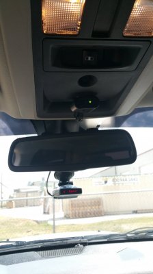

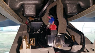

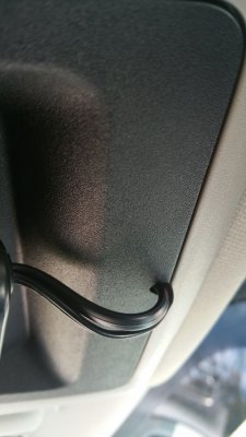

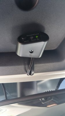

I hard wired mine into my rear window button. On the harness, there is a side with 2 wires and a side with 3 wires, I connected it to the middle wire on the 3 wire side. It turns off/on with the truck. And, the direct wire kit I purchased had the smartcord head, which I mounted to the upper console. The black portion of the console is very soft, so I use a drill bit sideways and made a very small crevice (if you will) for the cord to run "through".
Believe it or not, I know the RD is not "far away" (being on the windshield), but it's nice to be able to simply reach up and hit mute.

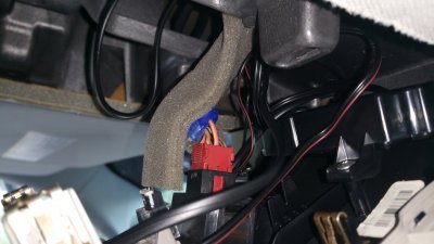

And a couple more shots. One from the side to show you it's the middle of the three wire side. The other is from the front to show which harness I tapped in to.
And, if you haven't already done it, be sure to pull from the side closes to you and/or the sides first. The side toward the windshield is "hooked" into the liner.
