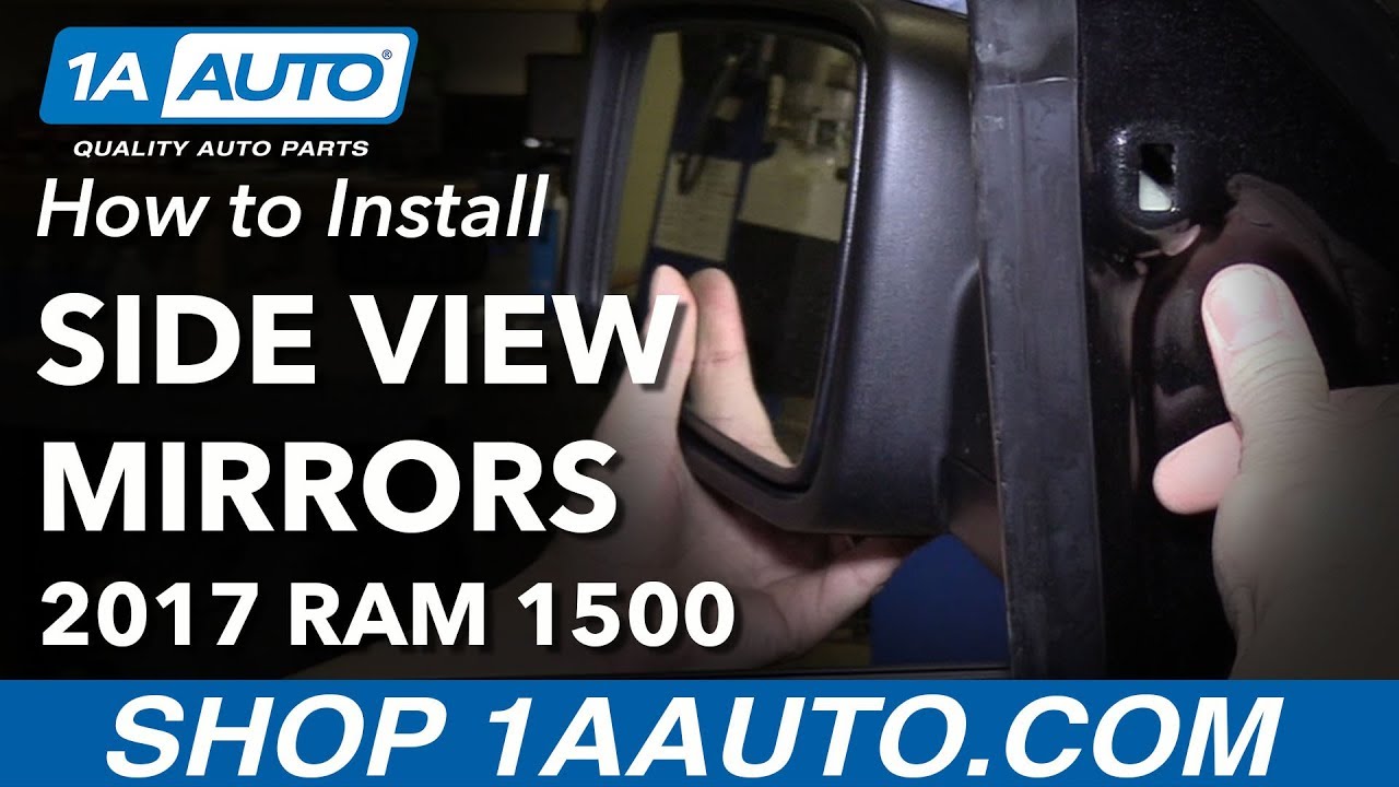

Video that may help better then our text
where he unscrews the 6 screws around the door panel, there are little plastic washer type things, those little things can get lost in a crack, lay a old sheet or something down to catch them
