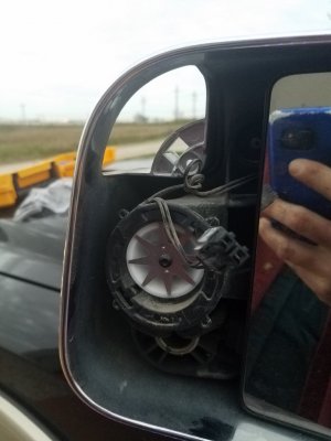

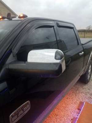

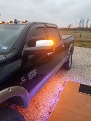

I had similar issues on my 2014. I took out the mirror and puddle lights and I had a lot of corrosion issues. Apparently water loves to get in there and stick around a while. I de-pinned all the connectors I could, cleaned them, re-pinned them and put dielectric grease, then replaced the puddles with the newer oem ones and replaced the mirror lights with smoked lens. The new model OEM puddles are a single light, black housing, and a lot brighter.
