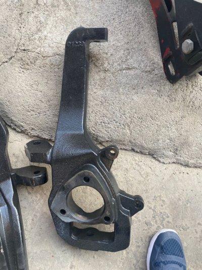

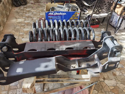

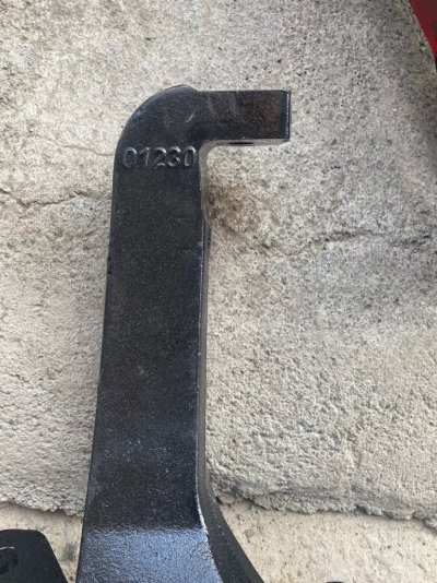

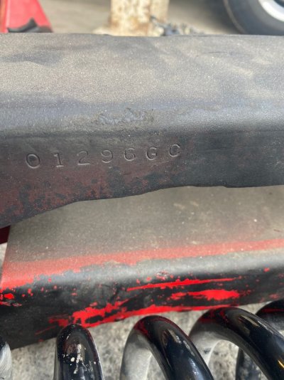

So.. as I said in another post, I did a thing. I bought a "used" lift kit. It's all in good order. Basically, the seller bought a truck and parted it out. He took off the lift it and kept it all aside and he said the only thing that he doesn't have are the shocks.
It was going for a really good price and so I jumped on it.
All the parts that I are in really good order; especially for used parts.
The seller can't really identify who is the manufacturer of the lift. From searching online, to me this looks like Superlift.
I look pictures of the serial numbers, if anyone is there that can help identify it.
WhatsApp Image 2022-03-02 at 6.27.53 PM (1).jpegWhatsApp Image 2022-03-02 at 6.27.51 PM.jpeg

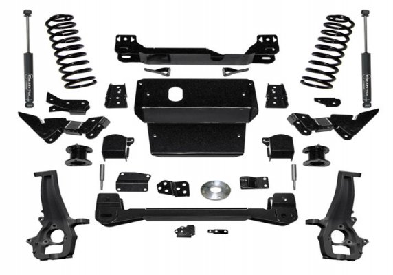

So far, it seems I have everything, except for the brackets that will extend the front shocks 4" and the extended shocks for the rear.
if this is a Superlift like I suspect it is, then I'm missing these parts..
Front shock extenders
Screen Shot 2022-03-02 at 23.50.57.pngScreen Shot 2022-03-02 at 23.51.18.png
Rear extended shocks.
If there is anyone that can help me identify the lift and source these parts, I would be grateful.

@j-b Thanks for that. There is an update.
I assumed that this was a Superlift based upon this picture; which was on the Superlift website.
Also the seller told me that the truck he took the lift off had Bilstein shocks; from what I know, is mostly known to come to with the Superlift and Mopar lift kits.
However on another thread, someone pointed out that the knuckles I had didn't look like Superlift. This is actually a BDS lift. BDS confirmed that this is BDS lift.
I guess that what what you get when you spend 160 USD on a lift kit.
In any case, I still need the spacers and the rear shocks. Would the ones for the Superlift fit?

BDS is one of the best you can buy so you really lucked out!
Those bilsteins, and strut spacer will still work the same regardless of brand.

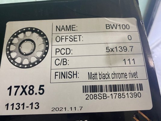

OK.. so I splashed out on a set of Methods.
I looked for something that will fit the BDS lift kit. Can anyone tell me whether these would fit?

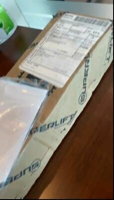

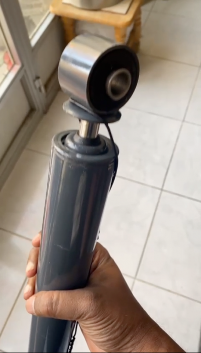

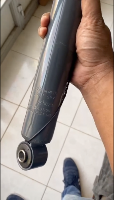

So before I found out that I had a BDS lift kit, I ordered the rear Superlift shocks off ebay.
This was the picture in the listing..
This is what I received.
Screen Shot 2022-04-03 at 00.47.42.pngScreen Shot 2022-04-03 at 00.48.30.png
The color was different and there was no "Shadow" lettering on it.
It did come in a Superlift box though..
In talking with the seller, he asked me to send pictures of what I received and he confirmed that these were the genuine Superlift items.
Is he right?
The truck is currently at the shop having the lift put in. I guess we will see if these shocks work or not.

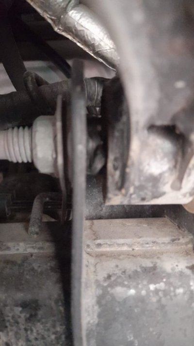

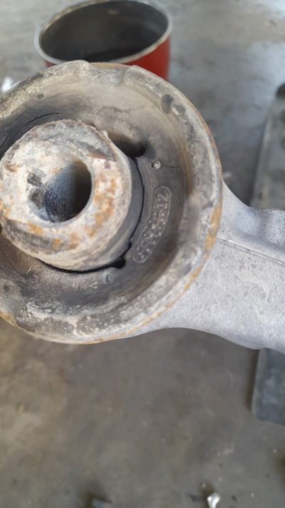

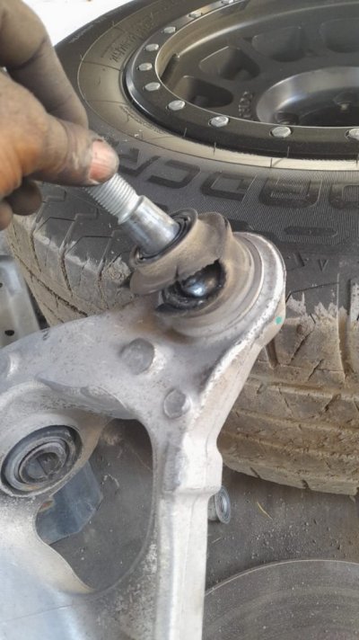

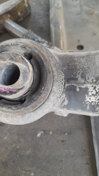

Update on the lift kit install.
My mechanic just told me that my upper and lower control arm bushes are completely shot.
WhatsApp Image 2022-04-03 at 12.11.46 PM.jpegWhatsApp Image 2022-04-03 at 12.11.47 PM (1).jpegWhatsApp Image 2022-04-03 at 12.11.47 PM (2).jpegWhatsApp Image 2022-04-03 at 12.11.47 PM.jpeg
He suggests that we change them right now; even if we weren't doing the lift.

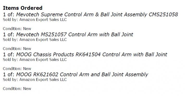

I'm looking online and so far the most cost effective seem to be ones from Moog and Dorman .. Are these good brands?
What are your thoughts on this?
According to this link, it should fit.
BDS recommends a 4 1/2” back spacing those wheels are 4 3/4” back space you should be golden as BDS usually leaves a larger than 1/4” variable for fitment recommendations

Considering my budget and the availability on the ebay or amazon. I went with these below.
I'm sort of bummed a bit as I was hoping to give the newly lifted truck a nice 4 day road trip to Oman and back and now I have to spend whatever I was saving for the trip on the suspension parts.
The good news is that once this is done, hopefully I would not have any issues with the bushes and stuff for a long, long time.
