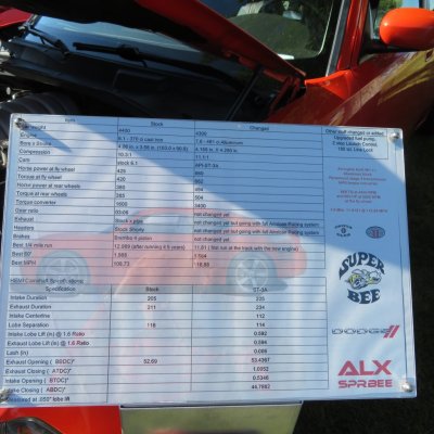

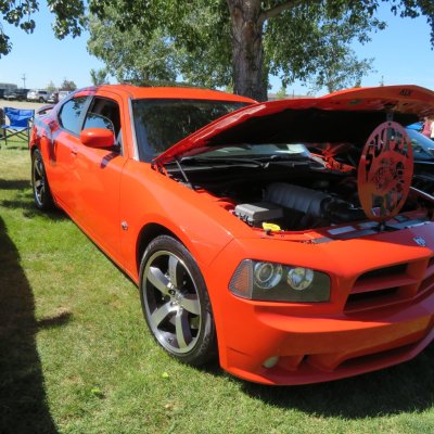

My buddy is running his Superbee tonight,and he's running 11.7's tonight with the DA at 3200 ft. Which is on par for what the car normally runs.
