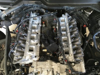

Well, I had a brain fart yesterday. Got everything torn down, new heads installed, new cam is in, bolted everything back up, started putting fluids back in the motor, and coolant is dripping out of the front of the passenger side head. I screwed up and put the head gaskets on the wrong side.
So now I get to pull the heads again and switch the gaskets around :emotions122:

Say hello to the new Moe's Performance project truck. It's a 2014 8sp with 3.92 gears. Tomorrow it gets torn down for a whole list of fun parts. Custom track intake, Moe's Performance 87mm throttle body, JBA longtube headers w/o cats, Modern Muscle ported heads, Modern Muscle ported intake manifold, A new Moe's Performance custom grind cam, ATI underdrive pulley, Billet Tech catch can, 180* thermostat, clutch fan delete, Belltech 2/4 lowering kit with Spohn adjustable panhard bar and Hellwig rear swaybar, Dodge SST 17x9 rear wheels with M&H 275/50/17 drag radials, and a Hemifever custom tune to bring it all together.

Could you please elaborate on the Custom track intake and MM intake? I went to thier website and only see a 6.1, is that what you are referring?
The intake manifold is just a stock 5.7 I take manifold that modern muscle ports. You can either send yours in to be ported, or they can ship one to you and then refund the core charge when you ship yours back.
Just checked their site & didn't see much info on the truck intake. What are the performance gains of this intake? What about when coupled with a ported TB?
I'm going to say none, until you increase the flow. You'll only benefit with heads and cam or FI.
