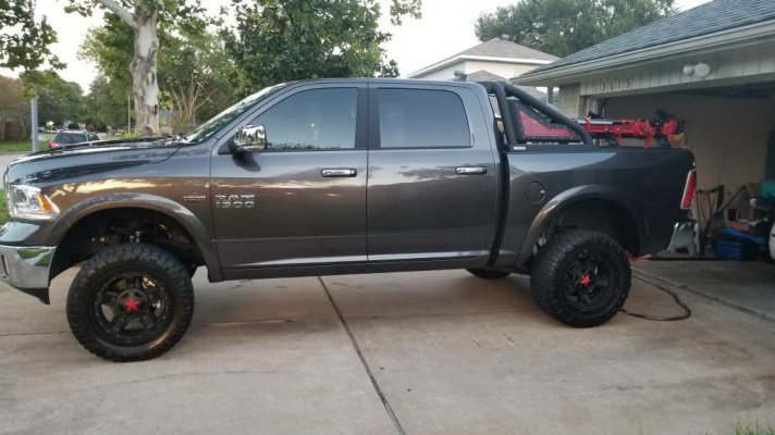

Just trade my air ride larimie Longhorn air ride went crazy and would drop to exit height on freeway dealer head no idea what it was so traded for 2018 Laramie and put 6"lift on it. Only lift for air ride is bds 4"e19081f296287fa37fc41be4ce0bb4a1.jpg
