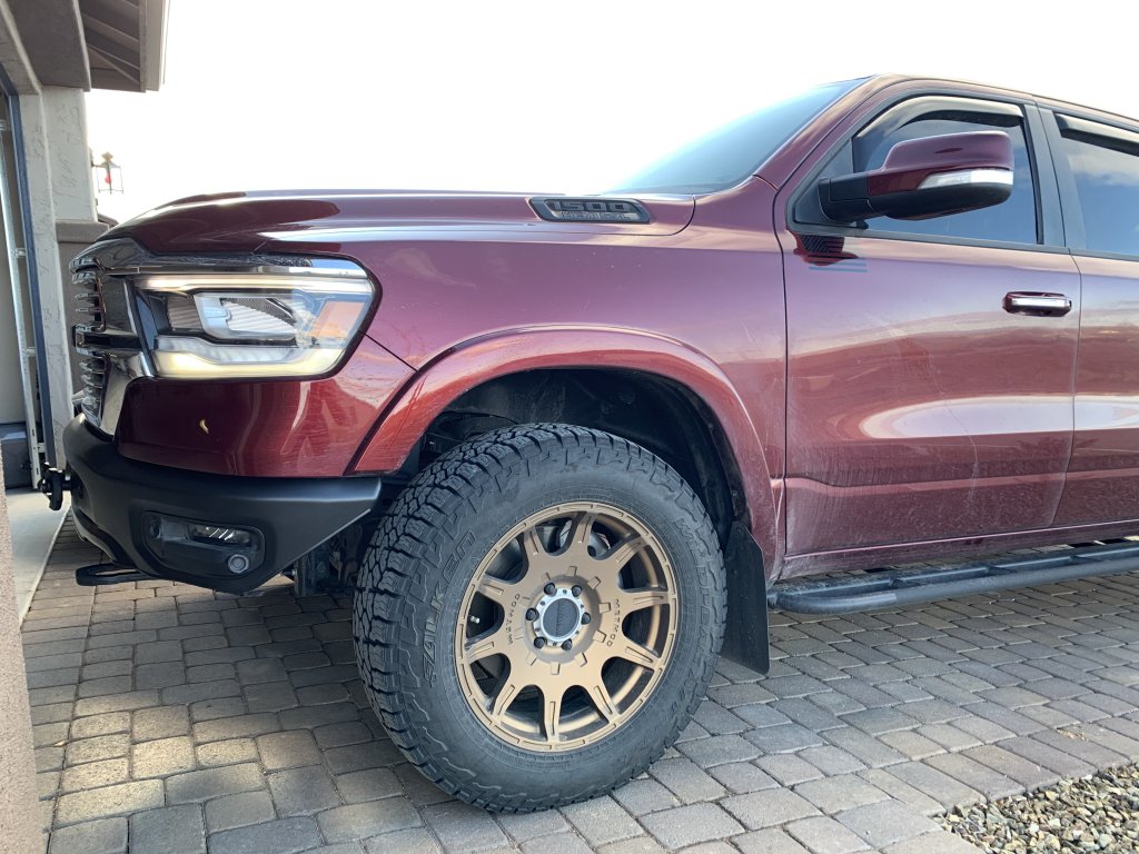

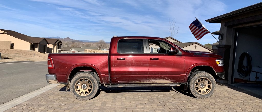

I ended up just adding the ORP spings to the mopar lift. It leveled out the truck and also compensated for the additional weight I've added to the truck. ~500 lbs worth.
After I added the springs:
Before I added the springs:
Hello, I had the older Mopar 2" lift kit with the spacer added along with ORP springs. I only did springs on the front did u do rear also? My front and rear are currently .5 " diffrence. Truck looks close to level.
