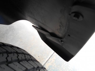

Installed Mopar flaps on my 2015 1500. Front are fine. Rear do not fit well at all. What gives??

My Husky flaps came with an extra screw to attach the bottom inside part to the fender liner

As ghetto as it may sound, I noticed this issue on my truck a few days after buying it. Looking around the house for a fix and not wanting to add a hole, I used a good dab of construction grade adhesive, worked like a champ.

Yeah I noticed that on mine too. It's almost like they weren't molded to fit on the oem plastic wheel well liners.

if you didnt already do it id suggest putting some 3m tape on the truck where the muflap sits on the outside of the fender. itll rub the clearcoat and paint off and leave a line if you dont

Yeah, that's what I did too. I also used black silicone gasket sealant to fill in any gaps where the mud flap and truck meet. It helps to keep the oem mud flaps from vibrating around.
