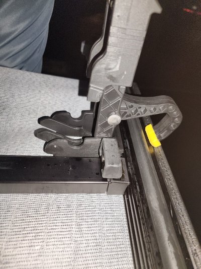

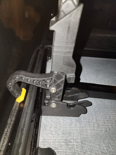

Bighorny, Having same problem. And it leaks. Ill have to put some foam tape between the side and plastic bed insert. But what did you do to make it tighter? The nuts on the latch system don't move and i can't figure out how to get under the latch, to get to the screw, without removing the fabric and i don't know how to do that. First ram ever, and first tonneau.

How did you fix this?
I'm having the same problem, but it's more than likely that I bought the wrong cover.
