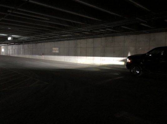

I installed mine tonight. 2016 and had to ream out the mounting tabs. used a file and it took 15 minutes. I turned them on in the garage, and they seemed pretty dim. I'll take the truck out tomorrow and get a better feel for the usable light as I have my garage bright as daylight.

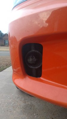

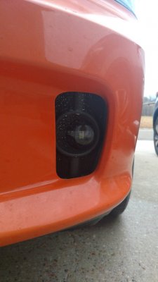

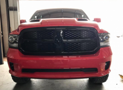

Here's the fitment on mine .As you can see, both are in the same spot .I'm happy with everything on these lights. Wouldn't change anything. Light output is great, and install was easy. Don't matter to me that I had to drill out 4 holes .that is not a deal breaker for me. Don't mind the dirtyness.IMG_20180126_173059456.jpg IMG_20180126_173107460.jpg

My truck is an ‘18 and my fitment is exactly the same as yours a little off on the drivers side. I also took them out and reinstalled to make sure I did’t mount it wrong and it’s the same.
you sure you have the oem brackets locating pins in the holes near the bolts?
My 2017 doesn't have that gap
