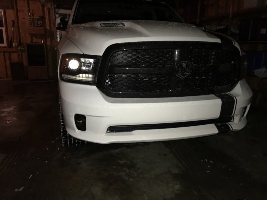

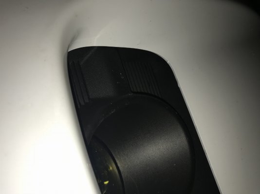

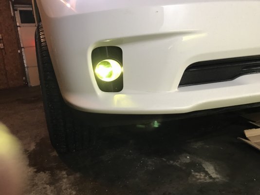

I don’t see how. What year is your ram? Mines a 17 and they’re flawless. 712ac7e4028c787499127f20cb35751e.jpgce5987b8b3908478a6ad9c7a9f7cfefa.jpg2dc626ec2695db522781a4d8a8a4dda9.jpg
Mines an 18 and they fit absolutely perfect on mine as well

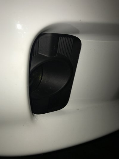

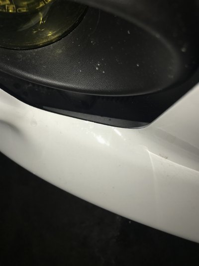

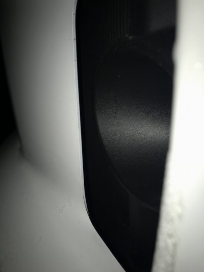

If everyone is expecting these things to sit flush up against the bumper cover they are NOT. They are made larger than the opening to protect the contents behind the fog lights. Like the wiring and headlights and engine components. If you noticed the stock housings were much larger than the opening. They are also not meant to sit close or sit flush because it would wear out both the bumper cover and the housings if they were rubbing up against each other. They are supposed to have some gap between them. That being said. Here’s how they should look. If yours look like this you have nothing to worry about. 1f8f7abbcf24576b5bab92c5fffb4229.jpgaa29c3ac91d81e2ed5b08218d2c56d2d.jpg03473072aa8c5a29dccca6a04a0b0177.jpg83c95b73226dee374b1d80b818e7cdc1.jpgc1c231a294e980ead76ff7901b73b258.jpga9e7c44b1abd5c5085e5cded7d9f9038.jpgd7b96cff2e70010ab43395db96fb5eb6.jpgcf985ee505e68a0cb3adad1376b4ffa6.jpg

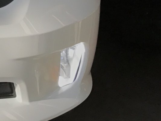

Here’s an example of how the stock housings fit in the truck. The stock housings have a larger gap at the bottom than at the top. 3e5c7f4fcf4d72feba7297144d544801.jpg

The gap is not to prevent rubbing. It’s so the light can be adjusted. It can’t be angled up or down if it’s pushed up agains the bumper. This is why the fog light is designed on a pivot on the sides and a rear adjustment. It it was up against the bumper not only would it not adjust but then it wouldnt rub either unless there is a ton of play that allows movement.
But you are right, the light is oversized to prevent stuff from getting around it but I’m sure stuff still does as there is a gap and at speed air will just force he water around it.

If it did sit flush it would most definitely wear away. Every single piece of your truck moves, twists, or vibrates while hitting bumps. We will all one day experience the wear of that pivot point. There are videos out there that show fixes for it? But even that pivot point will wear over time and your housing will become loose inside its assembly. And it could go either or both ways. It could not sit flush for adjustment purposes or wear purposes or both. They could have made the light adjust from inside the housing instead of the whole housing itself. Like how the head lights adjust.
