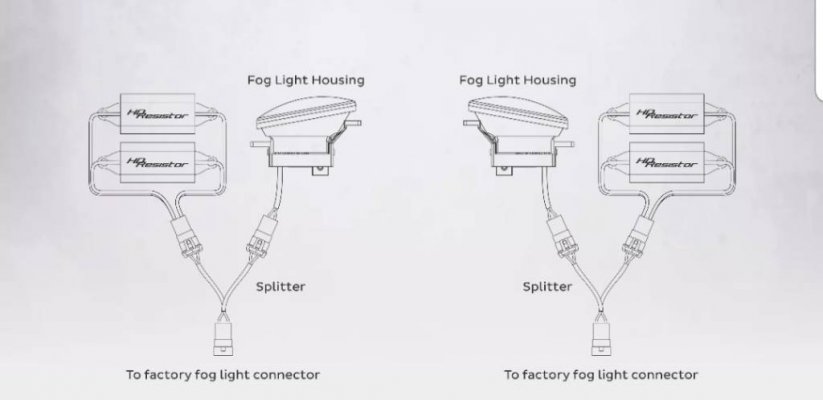

Can't seem to figure out why only the passenger side comes on. The driver side will flicker then stay off when I turn them on. I tested the resisters and fog lights and they are fine... So confused.
Any ideas on what could be happening?

Should I run the anti-flickers with the morimoto resisters too? There are currently 2 40 watt resisters per fog light. Do I just add the diode dynamics antiflicker modules to it? The resisters are not bad or seem to be the issue because I have tested them on the working side of the truck. Thoughts?

If you use AlfaOBD you don’t need resistors, in fact once set to LED the extra resistance will cause a code
Will try that. I won't fry the factory fog light wires by going the alphaOBD route, will I? I know with resisters they run hot.

you’ll be fine, many of us have been running that setup for a long time
