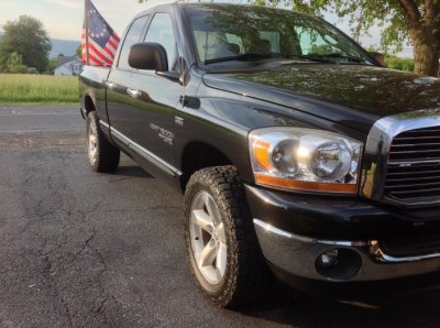

What you guys think of Atturo Trail Blade MTs? I like the aggressive look, once again this is a DD.
