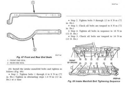

yeah, if you get a felpro gasket its completely fine to just replace that. You'll need an intake gasket set for re-assembly, as well as new intake bolts, I wouldn't try to reuse those.
For first timers giver yourself 4 hours to get it all done. You'll have to unbolt the throttle body and move it to the side, then you can either disconnect the fuel line (after relieving pressure with the schrader valve) or you can leave it connected and just pay attention to how much pressure you put on the connection.
The procedure is as follows. Remove the air cleaner assembly and vacuum or blow off all the garbage that builds up around the valve covers. Remove the radiator cap and either remove the lower radiator hose or open the drain **** on the bottom driverside of the radiator.
You'll want to do an oil change afterwards as well.
Once the throttle body is removed start unplugging the electrical connectors from the injectors. You might break a couple of the lock pins, but its ok.
At this point spray down the front four intake bolts with something to break up rust. The problem is dirt that gets into the holes and packs in between the bolt and the intake, they don't get stuck in the head often. Before you go to remove each of the bolts, heat them with a torch and quench them with water or WD-40. I do that three times and i've yet to have one snap on me after doing that. Otherwise i've broken 2 in the same spot.
Once you get all the bolts out, the intake mightnot come off easily, you just need to pry on it a little bit with a long screwdriver or crowbar to get it to pop up. After the intake is off, get a rag or something to stick under the intake mating surface on the heads so you can catch most of the oil gasket and rust as you scrape it off.
On the intake, the bottom is lined with bolts that holds the plenum pan on, these usually don't get stuck. You'll have to scrape that gasket off too.
Now is the time to spray cleaning solution into the intake valves on the heads.
Once you get the plenum gasket installed torque to spec. Then place the intake gaskets and reverse the removal procedure for install making sure to follow the instructions for torquing the intake bolts.
