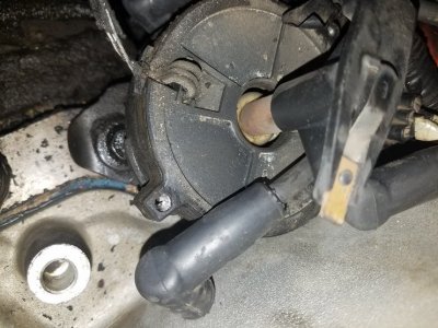

Good call reminding me about the distributor cap. It had a messed up contact and take a look at the wires going to the pickup coil! Could THAT cause the misfires? (Are YOU my mother?)

I'd try just cap and rotor first. If that doesn't fix your problem, then you'll probably be replacing the Cam sensor, but when you do, you'll mess up the fuel sync and need to get it reset.

Won't mess up fuel sync unless you spin the distributor which there's no reason to for that plate. All you do is pop the rotor off and lift the plate up. New plate fits in the distributor 1 way
