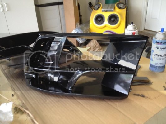

Always wanted to give this a shot and I found a good deal on a set of used headlights. That way if I effed something up beyond repair I wouldn't be stuck without lights.

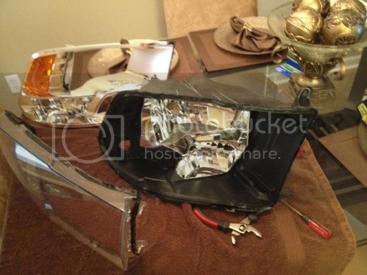

The disassembly. Baked at 250 for 17 min. Butchered the plastic around the edges pretty nice. Prob could have baked a little longer. Hopefully not too big a deal

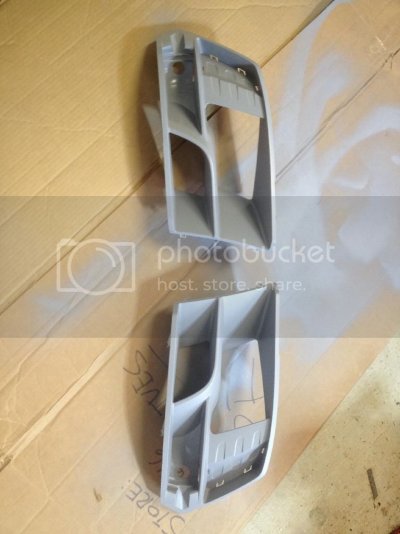

Primed up after a nice scuff with 2000 grit and wiped clean

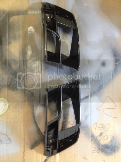

Spray bombed a few coats...
A few clear coats...

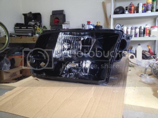

Test fit...

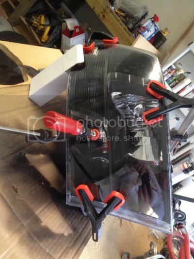

Clamped up for silicone to dry and final product....

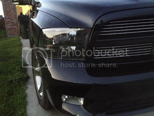

Hard to get a good pic. When I get home this evening and install, I'll post more pics.
All said and done, I've got prob 9 hours and $170 invested. Def worth it for the experience and I just love doing this kinda stuff. There are a few things I'd do differently if I did a second set. I little more patience for sure. Bake...pry...bake...pry.... Bake... I feel would have been better for not chewing up the housing as much. I also would remember to clean finger prints from inside the lens before I put them back together. I also would not step on the reflector again and crack it in half as I wanted to paint and re-use them.

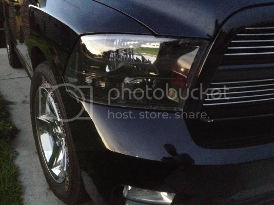

as promised...
Hard to get a good pic of em
I dont know if it was already like that before, but i realized that little white clip that holds the housing from behind, was cracked. It doesnt hold the light in tight to the fender anymore. 19/20 people prob wouldnt notice it but I do. Any one know what its called or how to replace it?

Lights look mighty fine to me.
I also did not spend enough time cleaning mine the first time before re-assembly.
When I take these apart for paint, I'll be beyond OCD.
