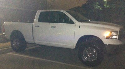

Dropped of the truck at Top Notch here in SATX today. Here is some info for those with a lot of questions. I know I had a lot starting out.
2013 Ram 1500 QC SLT 4.7L 2wd
Currently 3" of rake...will measure when finished
Kit: 7" Maxtrac $1025
Wheels: Raceline Renegade 17" w/ lug nuts $540
Tires: Hankook Dynapro MT 315/70 35" 50% tread $275
Rear Spacers: MotorTech Bora 1.5" $130
Install with alignment $500
Total: $2470
Pretty proud of my ballin on a budget lift.... :Big Laugh:
Pictures are posted! More to come!

Apologize for the horrible quality and lighting. Will get better ones tomorrow in the day light. I love it.
