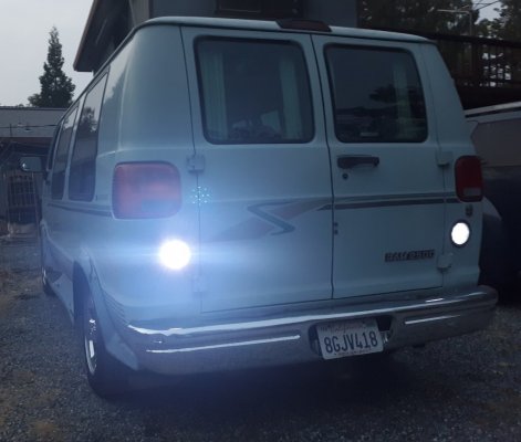

178K plus - picked it up four yrs ago in GA, incompetence of owner family led to its being parked a few yrs - exterior mold due to humidity in shade. . . . crankcase was 1 gal overfull! - thanx to Walmart servicing. Replaced with full synthetic. After cleanup, restoring spark plug wiring to correct order, found 2011 17" rims for sale - upgraded from 15" with spacers. Had mechanic replace water pump, radiator & hoses, overhaul the tranny. Since, have done my own installation of fog lamps & rear truck backups (rocker switches for both on dash, looks factory), running lights (below headlamps), new horns - all work done myself, hidden interior wiring. So, opened up stock air feed by removing baffle, undercut the intake hand (applied screen with JB Weld), cut 4" hole in plate below. Just recently put in set of Denso TT plugs & coil. I run with 25-30% premium fuel. All considered, I'm getting double the mpg of the original low rider. Thanks for your interest!
