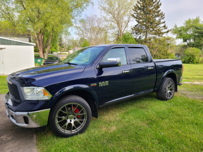

Hey all had some fun bringing back my 2015 Laramie paint.
So this truck I bought new in 2015 and now has 190K miles. I honestly probably never hand washed it. My daily work truck and just used the local no touch car wash. So it was way overdue. Did a three stage compound polish. First washed and clay bar. Then: 1= Chemical Guys V32. 2=Chemical guys V36. 3= Turtle wax hybrid polish and wax. Last followed up with Turtle wax hybrid spray wax. Had forgotten how dark the Blue was on my truck lol. Really brought the depth back. Impressed how well the Ram paint held up. I did not baby this truck at all, Ohio winters, many freeway miles in PA where they can use sand in winder etc. Best part my buddy just asked when I bought a new truck.

Looks great! I'm going to do thing to mine in the next few weeks. Same boat as you lol bought new in 15 and have only used the drive through no touch washes so it's LONG overdue for me too seeing as I'm from NW Ohio and this past winter was extra salty

You will love the results! Very fun and rewarding to see the truck look like new again. Only issue is now I hate when it gets dirty lol.

what did you use to apply the chemical guys products? just curious.. thanks

man, your arms must have gained 2 sizes bigger after doing all that.
look great, tho.
