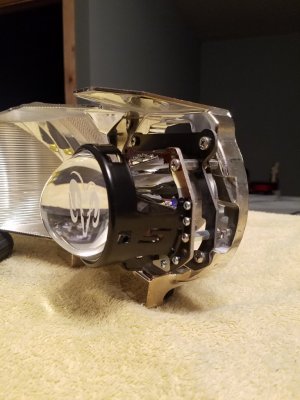

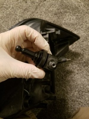

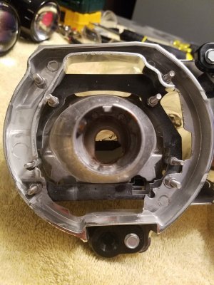

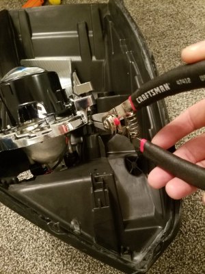

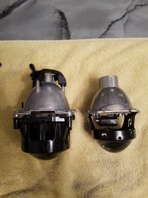

Opened up my OEM projector housings. Here is link outlining that processhttps://www.ramforum.com/threads/how-to-baking-open-and-re-sealing-headlig. Once opened, I finished taking everything apart. Signal led housing are just held in by 3 torx screws. Removing the inner reflector bowl was a little more challenging. Its held on by 3 ball and sockets. One of those being the adjuster. I heated the housing with a hairdryer, and used a snap ring tool to pry them apart. Couldn't get the plastic adjuster ball socket out. So, I removed the adjuster by turning it all the way out, then turned the whole adj part a quarter turn counter clockwise with a pair of channel locks. This freed things up so I could pull it out easier. Once everything was apart, I started mounting the new projector. I included a comparison of the oem vs the mini D2S 5.0. Oem on the left, D2S 5.0 on the right.

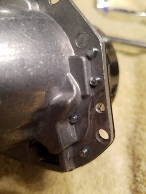

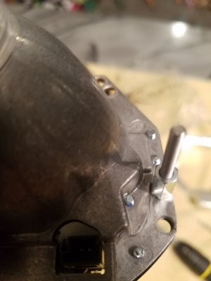

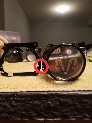

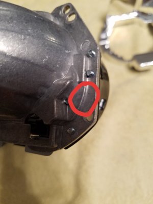

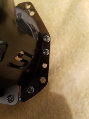

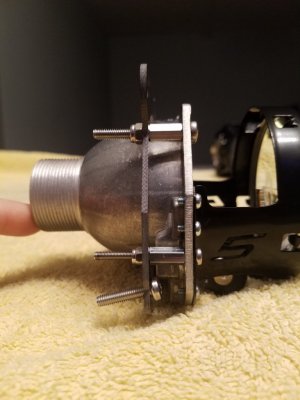

As I stated earlier the quick kit came with the brackets for the 4.0 version. Had to modify the projector housing in two spots to make the bracket work. I discovered this while looking around in a headlight forum. Can't take credit, but passing along. On the D2S 4.0, the bottom screw to the housing is removed and replaced with a bracket screw. On the 5.0, this has been replaced by a stand off post. So, in order to make things work you need to grind down the post (used a dremel tool). I removed the 6 screws holding the lense on before doing any grinding. Once ground down, I re installed the lense and used the hole in the housing as a guide to drill out the hole. The second spot you need to take care of is on the back side of the projector. I had to grind down some of the projector housing so the bracket spacer would fit. Pics explaining the spots and what was done:

Can you tell me the length of those standoffs?
I’m doing the same mod but not from a kit. I just need to know the spacing. Also how thick is the bracket 1/8”?
Thanks
Jack
Are you asking about the length of the spacers between the bracket and projector? 12mm,
