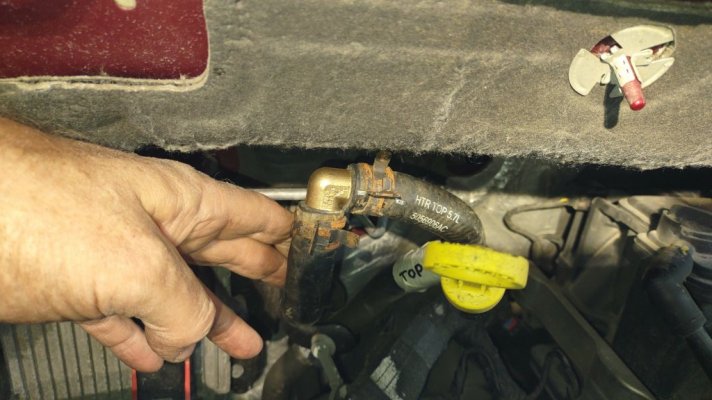

I going to replace my heater core, it is leaking really bad. I need to take it to a shop to have the refrigerant removed from the AC system. I've temporarily bypassed the heater core using a 3/4 pex 90 degree elbow to connect the two hoses so I can move in the driveway as needed without leaking more coolant into the cab. I'm about a mile from a shop that can remove the refrigerant from the vehicle. Can I have this in place long enough to drive to the shop and back to have my refrigerant removed, without damaging the engine?

Stuff not going into the heater core not hurt as long as U have a continual path between Motor, Rad and Water Pump. My wife had a 1990 Lumina with the V6 and transverse mounted engine. We had the hoses rerouted so it looped back to the water pump. I did the heater core on that motor, what a ROYAL PITA. I had to break loose the motor mounts, loosen transmission mount and use a come a long to pull the motor forward to give me enough room to take care of connections on firewall. NEVA again on a Front Wheel drive vehicle. LOL. I am not a mechanic, so if U not sure, check with someone U trust. BUT if you pull both hoses off of heater core and just connect, U R still having a coolant path just without the core in the middle, no issues. U might wanna get fixed before it gets cold up there considering where U R.

Solved. I'm replacing the heater core and evap core on a 2013 Ram Express. I hit a roadblock. I cannot find the last fastener bolt on the firewall holding the unit in place. Any tips?
There is one nut behind the wire harness plate.
Follow the two rubber hoses that connect to the heater core to a bend on the lower right side of the wire harness plate. The hoses are attached to a connector that hides the second nut. I will add a picture of where the two nuts are.
Mine was behind the ECU, had to pull it off to get to it, the other was right below the hoses
