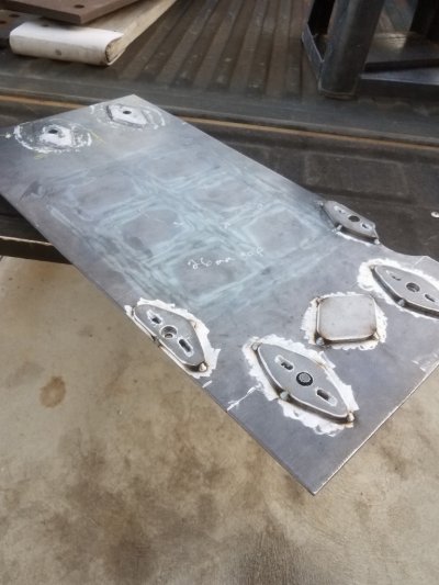

my homemade rock sliders

plus I looked into wk sliders but the cost with exchange and shipping to Edmonton it didn't make sense

the big plate is 3/16 with 3/4 tube welded on the other side for reinforcement below the tcase. the ears that the bolts sit in is 1/4. im using all arp 12pt shouldered bolts
