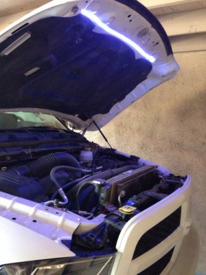

My express didn't come with a work light in the engine bay so I made my own. Turns on when I pop my hood ImageUploadedByTapatalk1407968323.099117.jpg

Very nice. What kind of switch did you use to have it turn on?

It's a pressure switch, so when my hood is closed it pushes the pin down disconnecting it from the ground. When it opens it the light is grounded again
