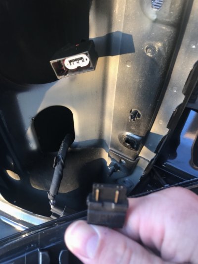

Well, after much anticipation I got my amazon tail lights and they don’t connect. Boy am I pissed. I made sure to order the ones meant for none OEM LED and the connector is wrong. Unless I’m missing something here. The ad also states 2009-2017 Ram 1500.
Am I special ? Or is my truck special ? The real ****** part is I ordered these on the US site to my buddies place in Rochester. He dropped them off an hour ago. I went to do the easy “plug and play” install and BAM! Won’t connect.
The truck end and stock light is a 3 prong connector and the LED aftermarket is like a flat connection. #confused

Take the sockets/connectors from your original lights. Remove the bulbs and plug those connectors in their place.

What!?? LMAO. I did ! I removed the connector plugged into the light bulb assembly on my stock lights and it doens match the one on the back of these aftermarket Led lights.
I’m having a bad week and maybe my brain is fried. I don’t know. But this shouldn’t be this hard right? The connection coming out of my truck is wired to the plug. And the plug coming off the amazon lights don’t fit the connector. When I look at the connection behind the factory light it’s flat prongs

You may need the harness from your old tail lights.
truck harness >>> Old tail light harness >>> New tail lights
So plug the new tail lights where the bulb would go? The thing I twist and pull out? So plug the new tail lights where bulb goes and plug the thing I pop out into the plug coming out of my truck!?
I think I may have had a stroke LOL. I’ll try this.
I must say amazon has been amazing. They said they’re send me new ones. I might have to cancel that whole thing if this works. Stand by. I’ll go try now LOL.

^^yes, you have to reuse the light bulb assembly from your stock lights. That flat connector you have pictured plugs directly into the socket, instead of the bulbs that are there right now...sorry my first post wasn't very clear.

No no. You were bang on. I’m just a *******.... The lights work! I just assumed that the harness holding the light bulb was a throw away and that the new light had its own thing. I should have known by the gaping hole that would have been there. I should not do any mods myself moving forward and should always be under adult supervision LOL. Maybe I should even start wearing a helmet!!!

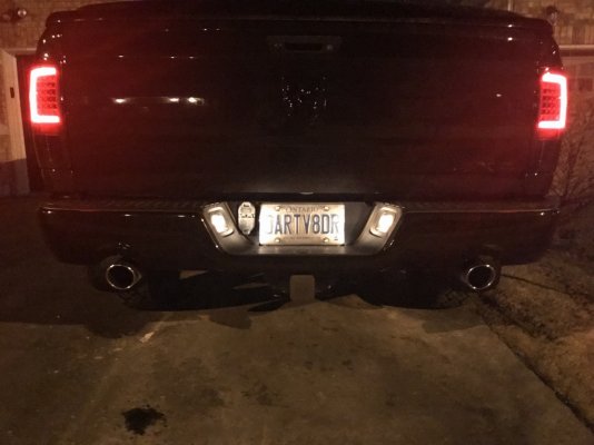

It’s 9:30 PM. 30 F outside and I’m a couple beers deep. But I got er done ha ha ha. They look amazing. I love the C shape albeit I’m sure they’re not for everyone I think the smoked out lens and C shape looks amazing on my black truck. I hope they last (fingers crossed)
