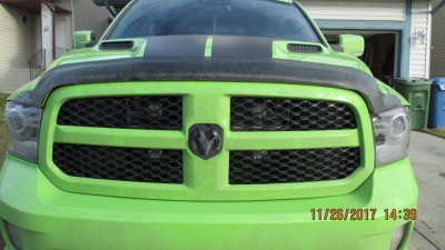

I removed them to install my Rigid lights. I have 4 mounted on aluminum attached to the upper support. I guess now I am re-installing the shutters without the middle slats. If I get this figured out I'll post pic's.
